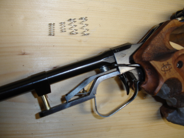

Here is one more suggestion sent to me by a free pistol enthusiast
"Subject matter can be achieved by lightly-counterboring (round-flats) the wooden fore-end in the area corresponding to the "bridge" (big lever). By stuffing in springs of different wire diameters and/or lengths and/or use of shims, I got a friend's TOZ to have a trigger weight similar to his NRA Match 22, within measureable limits.
The spring-loading range is widely adjustable with a good selection of springs on hand; and may even be externally-adjustable with some more fiddling. "

Ading Sprungs to the Trigger
Post by paulo »
Pick and choose what works for you, with some careful spring combination a two stage can be mimicked.
This is only an option for shooters that like heavy triggers.
