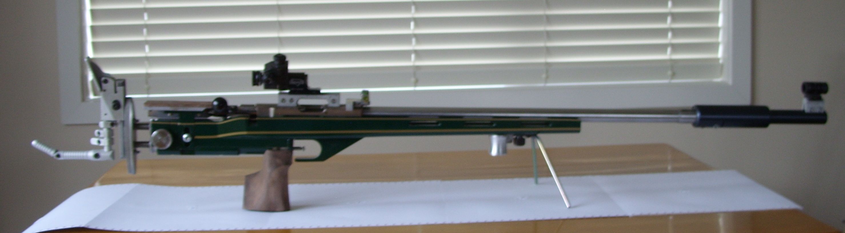

This is my latest project.
Alloy milled stock.Ugly green powdercoat(it looked great on the sample)
2013 Action set back as semi bull to make loading like a Bleiker.
Trigger is mechanical now -electric was a bit unreliable
Shilen barrel .As this is a prone only rifle I have kept the Butt mount up more in line with the barrel.
I am hoping to make another one for an 18 series action.
Jason

That looks really funky -- nice job! But don't you find it hard to cycle the action? Or are you able to reach the bolt without lifting your right elbow?

GeraldC wrote:This is my latest project.
Hi Gerald
I agree that is a nice bit of work. Have you considered makeing a cranked bolt to make easier? Any chance of some clearer or close up shots of action & trigger area? & big question how have you found it? is it working for you as you hope?

Hi.
Bolt could do with a crank but is not too big a problem.
I flick it up and back with my thumb -load-forward with thumb and close normally.
Rifle shoots well -soaks up recoil nicely.I need a few weeks to
see how it goes.Hardest part is I am past my prime and cant do this or
any rifle justice anymore.

Gerald, I like it :)
I'll soon have a similar stock made for me, aluminium (milled) with straight profile of the neck behind the pistol grip. Also for a 2013 (and also soon with a Shilen 4G ratchet, replacing my factory barrel).
I shoot prone only, so I was thinking this design would be good for the recoil, just like Keppeler and more.
Anyway, what's your first impressions of shooting this 'straight' design, compared to a regular stock? Whats good? Some bad experiences?
Just curious :)
Cheers

Everthing is fine except for the area behind the pistol grip.
I am modifying to get my thumb more comfotable.This means redesigning the trigger mechanism which was set up that to set the action back.
My 2013 action is back in the original wood at the moment and I am adapting the alloy stock for a round anschutz action .
My original intention was to make a stock for an upgrade from an old woody
with the loading ergonomics of some of the new rifles.

Do you have a pic or schematic of the trigger extension, or could you explain what you did. Looks like it might be a straight rod, but I'm curious what kind of bearing it rides in, if any to reduce drag.
Greg
GeraldC
Posts: 49
Joined: Thu Aug 26, 2010 1:18 am
Location: new zealand
Post by GeraldC »
Hi Greg.
5mm stainless tube tapped for button head screw.
Circlip to hold in place running on plastic low friction bearing out of dead printer that pushes on shortened trigger.
I am now modifying this to take miniature rod ends to get more clearance above top of thumb.
Gerald

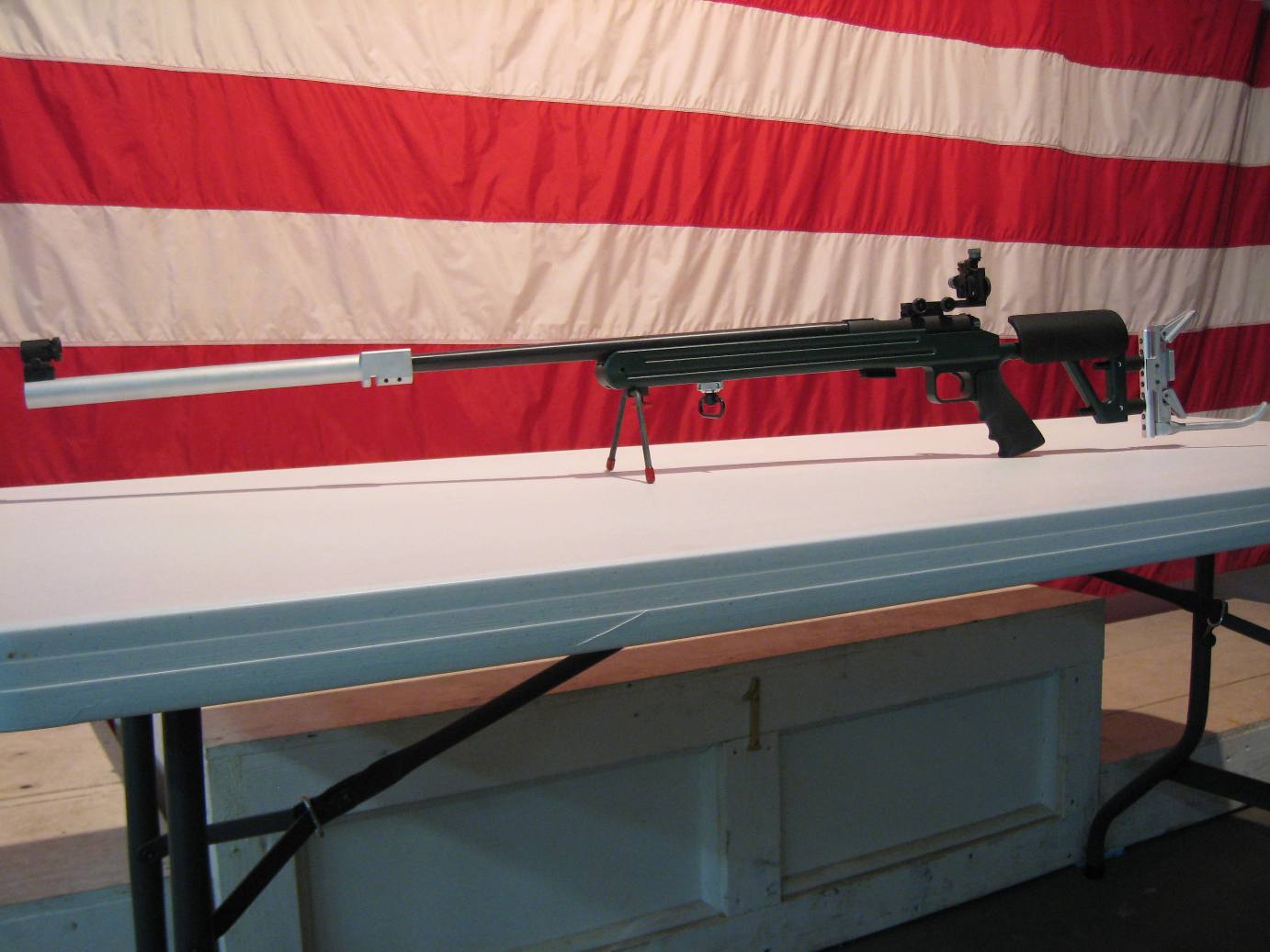

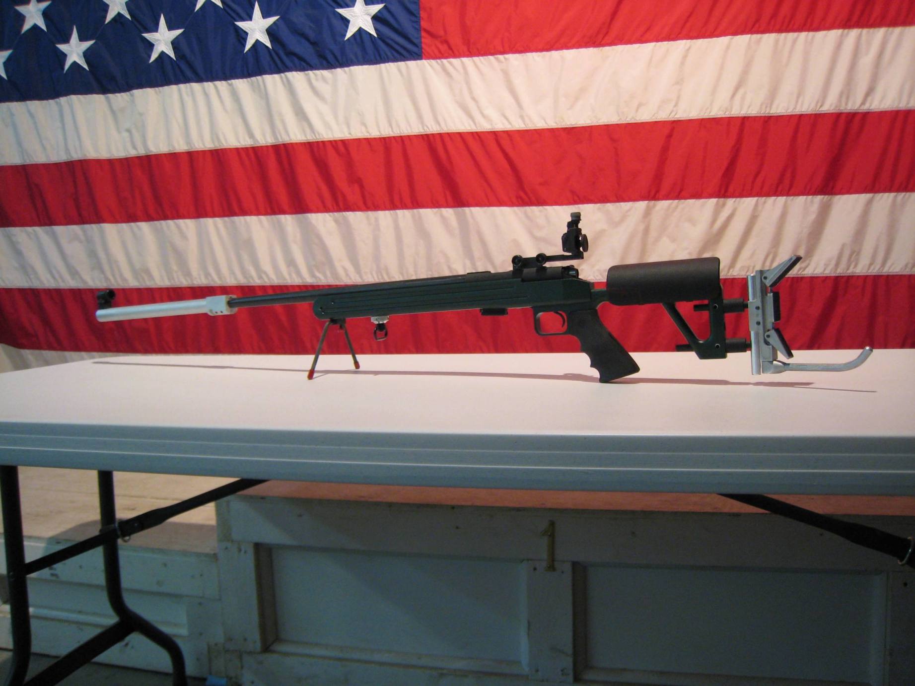

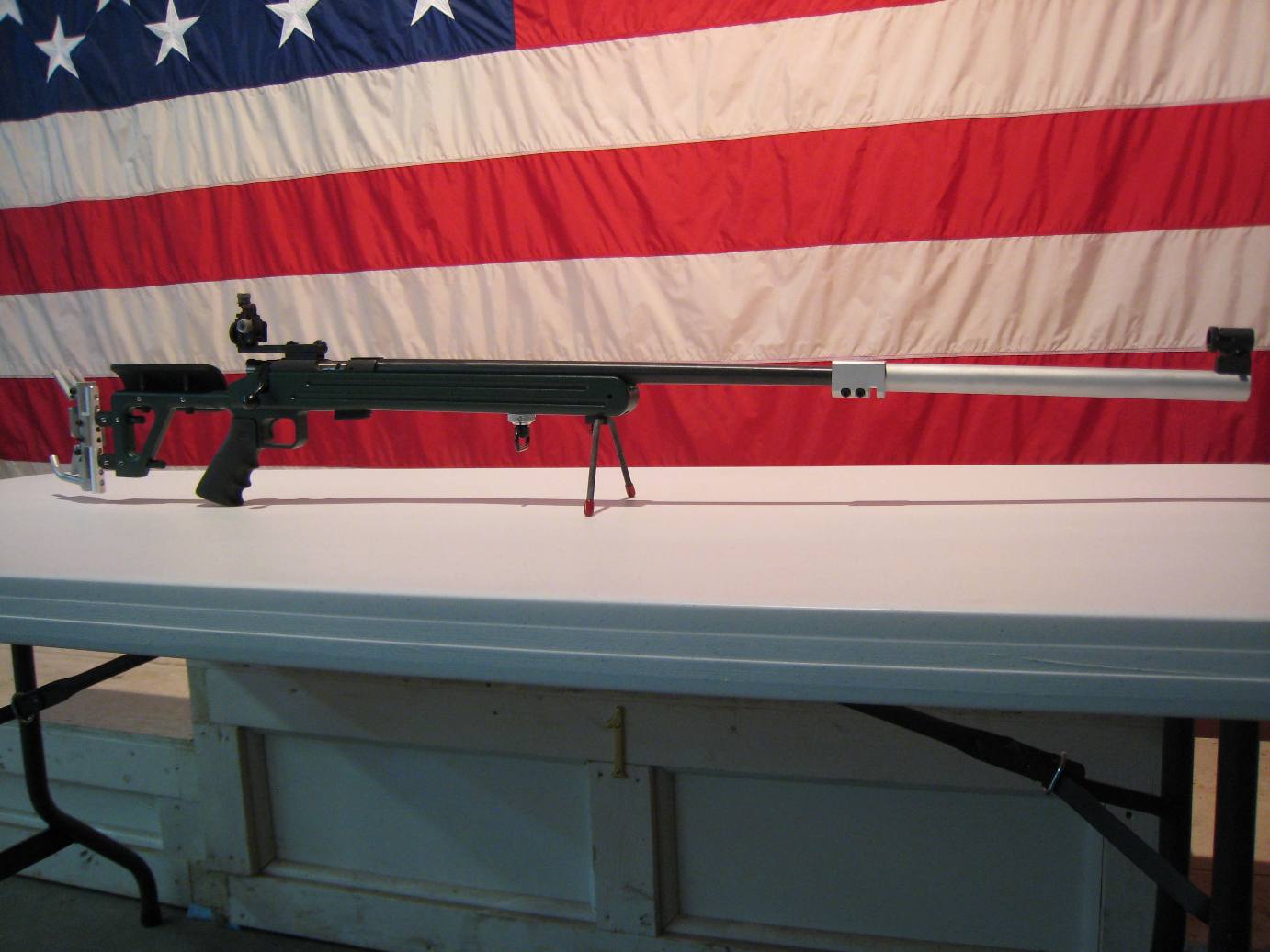

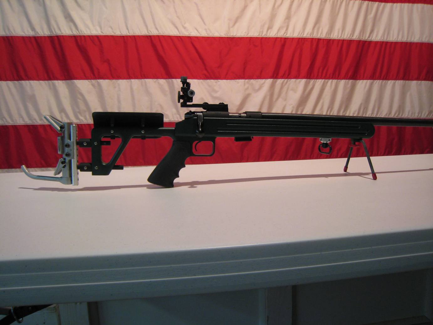

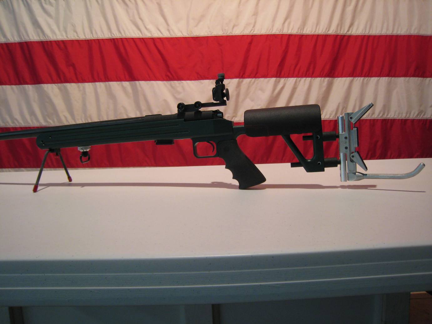

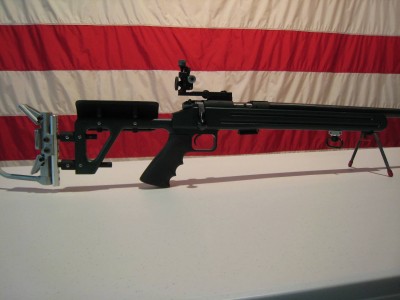

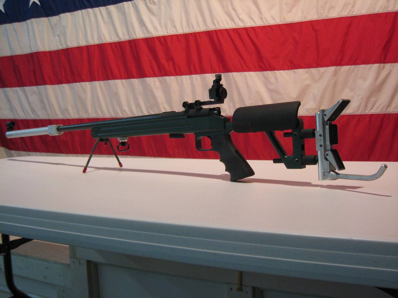

Here's a Smallbore Project we've been working on at The Ole Mill Range.
Thoughts?

GCSInc
Posts: 246
Two More
Post by GCSInc »
Here are a couple more...

Post by Vlad »
Nice looking stock, alltought too "tacticool" for me :) And I have to say, what's the deal with AR- grip? Why you americans allways want to but it everywhere? :)
Nice sightextension tube you have there, allmost like my own desing :P
Is that repeater? What action is it? And what discipline it is for?

GCSInc
Posts: 246
Project Rifle
Post by GCSInc »
The concept for this project was that a young Athlete should be able to earn the money to pay for this equipment in a single summer working.
It sports a CZ-452 Varmint taper Barreled Action and Trigger. PDC Custom Stock. Anschutz Sights, and yes it would take a 5 or 10 rnd Mag, but the single shot sled is installed. The Butt plate is from ESP. Extended Bloop Tube for sight radius.
It's a 3P rifle and it's our attempt to get an affordable (less than $1000.00 USD) Rifle into the hands of our juniors and beginners. For 50' - 50 meters, this Rifle should compete very well with Rifles costing much more. It's a starting point.
As for the AR-15 style pistol grip, there are so many variations on the market, a young shooter can find something suitable for less than $50.00 USD to fit their hand and needs. You can pay 300.00 or more for a grip, but these work fine.
If there is a better, cheaper, more adjustable alternative, I'd very much like to hear about it.
Thanks,
Roy McClain

Vlad
Posts: 7
Joined: Thu Jun 10, 2010 1:41 am
Location: Finland
Post by Vlad »
I'm sorry, your concept "Cheap, rugged and good rifle for juniors" yhat's great!
And what come's to AR-grip, sure it is best solution in US where are so many AR accessory manufacturers :) In europe, it might be most affordaple to make your own :)
I tought this was another "AR is best rifle ever, so I have to make my old winchester look like it" ;)
Cheers!

GCSInc
Posts: 246
Waiting for Accuracy Testing
Post by GCSInc »
Proof will be in the "pudding" when we bench it with several good lots of ammo. Results to follow.
