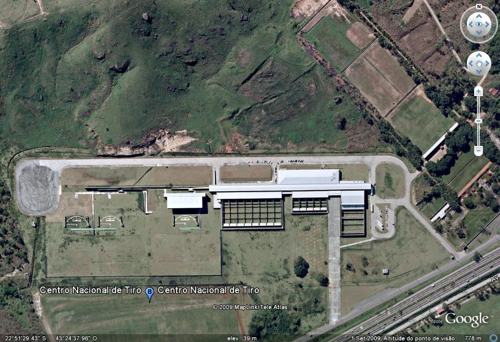

Pictures of the place
Post by jacques b gros »
This is the thing. Old pic, grass is greener now.
From the right, facing south (don't forget, other hemisphere):
Finals' range (installing electronic targets 2nd quarter 2010)
25m range, 50 posts
50m range, 60 posts
Skeet and others, 3 ranges
Facing north the 80 posts 10m Air range and offices.
Connecting both a 2 floors corridor, a "mere" 280m long (measured on Google). No wonder a RO is 3/4 dead after a 4 day match.
Notice that there is no heat outlet in the long ceiling, and the thing is horizontal. If the breeze takes a day off, the 10m range gets crowded.
the flat roofs add to the noise and traps heat. Someone forgot to check the weather...

If the roof can take the extra weight, grow some native plants on it. Look up the term "Green roof". It will reduce the heat, at least. Might even reduce some noise because it will be thicker & more rigid. (just a guess) Most sound reduction, of course, needs to be inside.

A green roof would doubtless look nice and yes, probably absorb some heat, as well as insulating the roof in winter.
However, plants outside will do next to nothing for the noise inside, since the noise is being generated indoors, although they might reduce noise pollution in the surrounding environment, which is always a plus.
