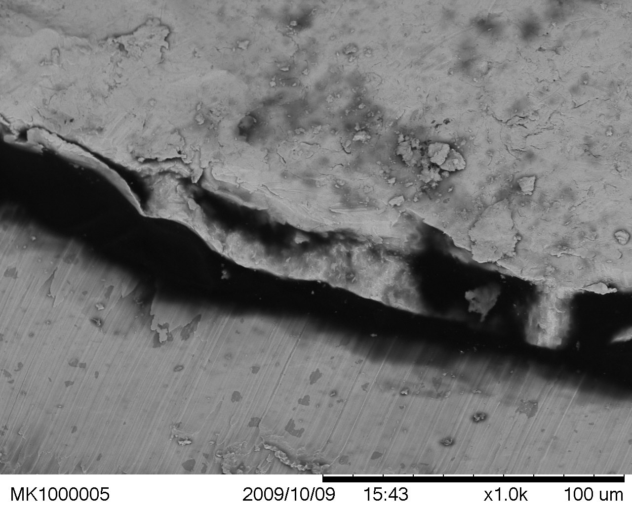

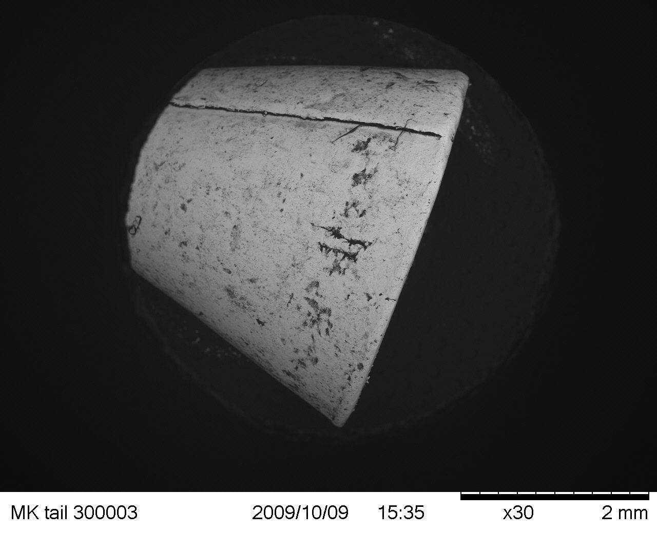

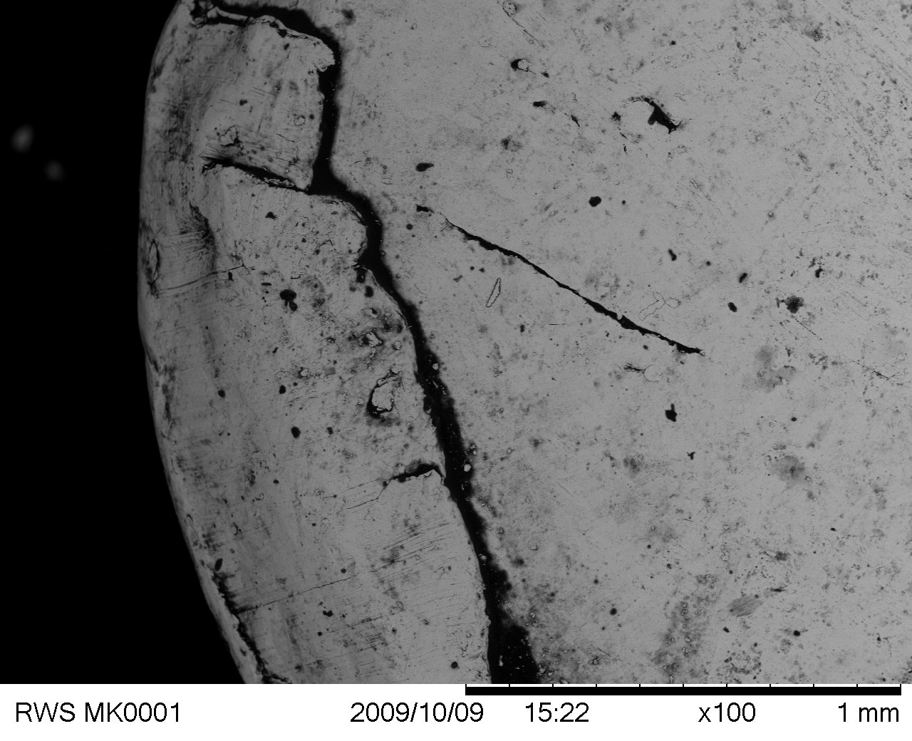

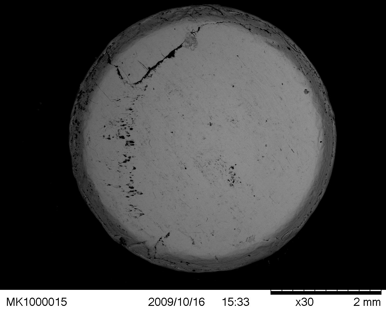

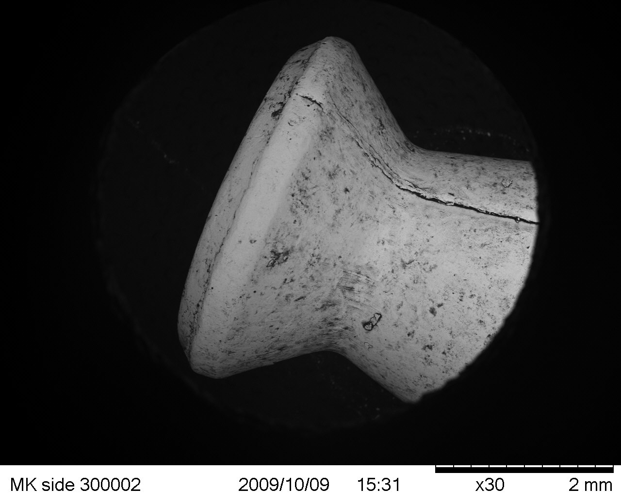

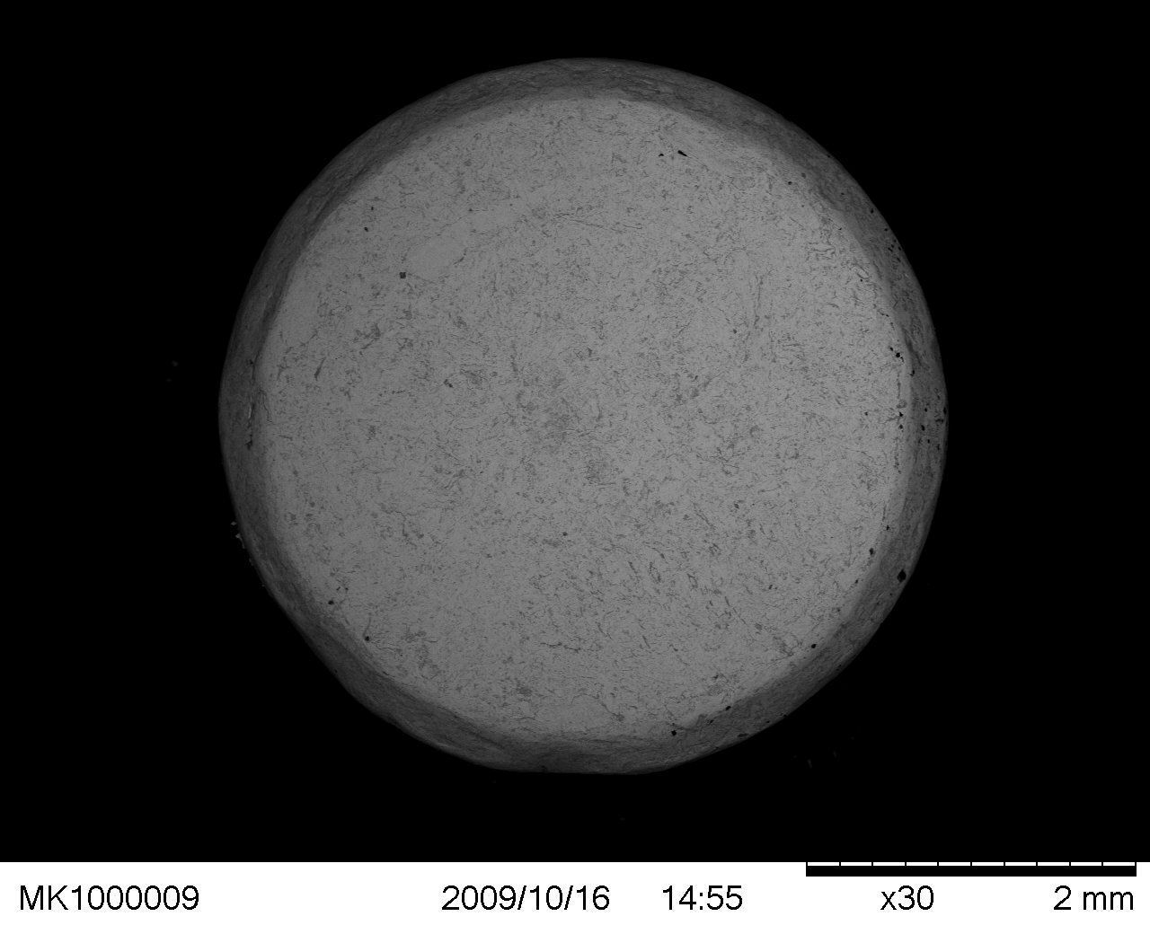

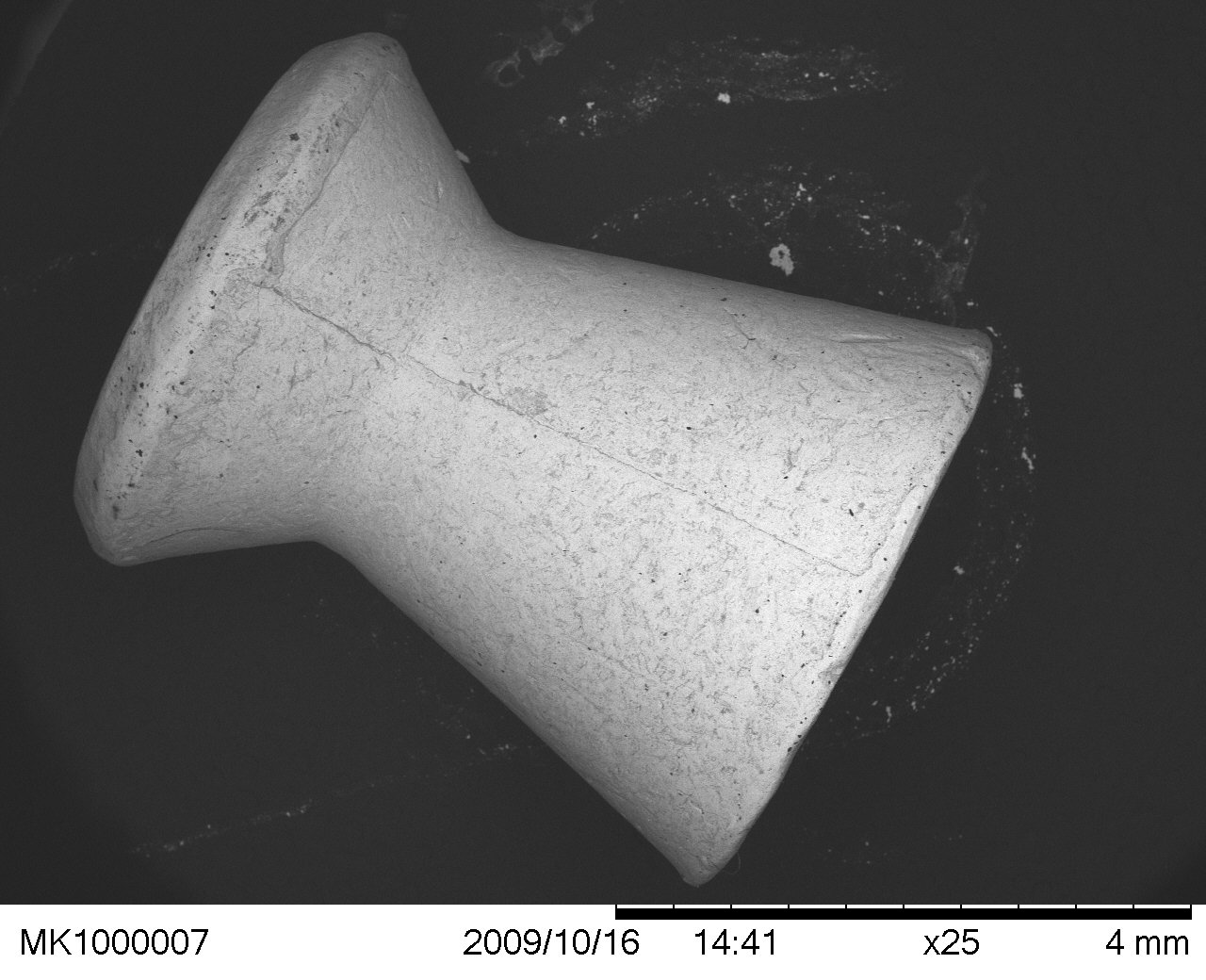

I recently took these images on a scanning electron microscope. It's an RWS Meisterkugeln out of a freshly opened box. Most images are at 30 X magnification.
The darker areas are actual pits on the surface.
On the left side is the beveled edge of the pellet face.
This is the seam between the two halves of the mold, as they leave a crevice along the length of the pellet. This is at 1000 X.

really cool! got some of other pellet brands to compare?

I want to optimize this so I can get a whole pellet in the field of view, then I'll take a peek at some H&N Match and RWS Hobby that I've got. I'll post pictures if they turn out.

Ricado, great pictures and a very interesting subject.
You will find that the 'high end' pellets such H+N Finale Match, RWS R-10, Vogel and JSB Match will not have a moulding seem as they are made from the extrusion method rather the moulding method.

High end pellets are not extruded, they are swaged in a 2 piece die. They will have a part line (seam) on them but the quality of the tooling makes it hard to see. As tooling wears, the line will become more visible and that set of tools will be used for lower grade pellets.
Low end pellets are often made by passing them between forming rollers, hence the knurling.

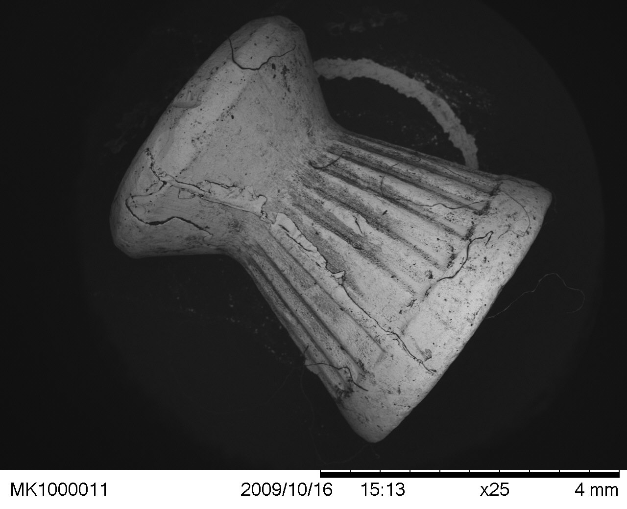

Comparisons between H&N Match and RWS Hobby. The former looks pretty nice, I think, while the latter looks like a lump of lead. Still, if it flies true, who cares?
This IS a Hobby pellet
