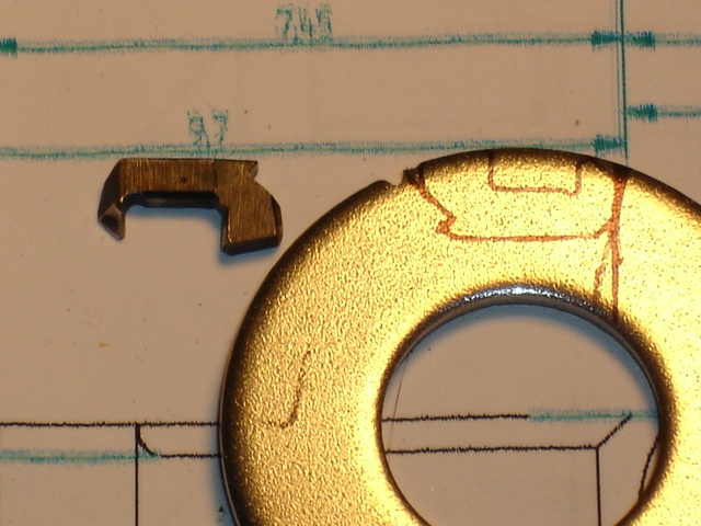

After enough wait from two machinists, I got going with building one myself, I will post some images for the ones confortable with a Dremel.
I crazy glued the broken extractor, traced it on a flat 3/4" flat stainless steel washer, and I will be roughing it tomorrow. Just tested the heavy duty cutter discs from Dremel and they work fine so it should be an easy job to do.
I talked with a person I consider very much, and he asked me if the gun needs an extractor at all, that the old guns didn't even use one, and for me to try to shoot it without the extractor, has anyone tried this, please let me know, it will save me the trip to the range.

Tried to shoot without the extractor, and it didn't work reliably.
The good news is, I found a machinist to do it, and it looks like he can do about anything, he was testing hardness today, and said he would do a bar to spec asap, so he can then make more if needed.
He is building them based on the blue prints above, I should be getting one in a week or two.
I am not looking for 100% replica as long as it works.
If anybody needs an extractor for the IZH35M just PM me, and I will put you in contact with the person making them, but first I want to make sure it works, so sorry for the wait in case you are interested in getting one as well.
