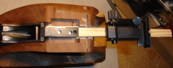

Take a pick at the morini rear sights http://www.gartlandprecisionllc.com/toz_pistol/100_1534.jpg , I am also trying to see the consequence of increasing sight radius with the original sites, but the relation to front sight changes and the gaps become wider as you move rear sights back, the morini rear sights gap can be changed in increments of 1mm and that makes them ideal for what I am trying to accomplish.
 Description:
Sight Radius extension
 Filesize:  77.94 KB

Interested idea Paulo. One thing you might consider first is how this would change your perception of the sight movement. With the rear sight that far behind the hand, it will now start to move in the opposite direction of the front sight as the hand moves. The hand is now the pivot point. With the reat sight on the pivot point, or nearly so, the movement is not magnified as much. It would be interesting to see how the perception of movement changes if you move the front sight out as opposed to moving the rear sight back. Sight radius is important in precision shooting. More radius better enables you to call shots. However, the extra radius can negatively affect trigger control if your movement begins to show up too much thereby disturbing your concentration. Just my thoughts and it is an interesting idea.

It groups great, front sight focus is PERFECT, yes you see more movement but the great front sight focus overrides it, it will take practice to get used to, but I am very happy with the results, doesn't fit the original box.
Now that I know it works for me, I am finding a machinist to fabricate an extension in steel.
