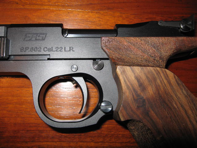

Two pics of 602 i'm evaluating: magazines, trigger blade and hold open button no wear, also screws head untouched .
For the spares, no problem: i'm qualified for Italian Championship (owr final round) in September, i think Fas there will be for assistance, i'll put the gun in their hand (either 602 or 607) for inspection and spares replacement.
The grip don't fit me at all either on 602 and 607: my hand had extremely long palm, requiring rink grip thick version, the local importer is on the match also at September, so will buy a custom grip any way. (add bucks... ;()

LukeP wrote:For the trigger assembly screw, i found an old topic (maybe Warren?) describing the way to solve it: changing the screw with a different head.
That was probably me. The problem with the domed head socket screw is that it takes a smaller key than the standard head. It can therefore be difficult to tighten it sufficiently without rounding the corners. The problem with the standard head is that it is slightly too high and can rub against the underside of the slide. A few strokes with a good file across the screw head solves that. You then have to be careful because the larger key size can let you over-tighten the screw; use common sense.
Those pictures do look like the 602 is in fantastic condition. The first signs of wear would probably be on the slide just at the back of the magazine/ejection port. Even better IMO, the gun has the heavy barrel weight. If they were suddenly to change the law in the UK and let us have cartridge pistols again I would be fighting you for it.

Other pics for evaluation.
If you do take it to the Italian Championships then it is a good idea to get FAS to check it. If you ever run into a problem getting spares then although it is a bit further away, Viktor Odermatt near Zurich has a fantastic FAS spares stock. He's also pretty good at working on them.
I'm Italian, so just a call directly to Fas and they send you whatever you need in small letter; the local shop is able to work on it in case of major fitting problem and you can go directly to Fas base in Milan, all year long, and receive full assistance; definitively not a problem at all at least in Italy. ;)

LukeP wrote:Other pics for evaluation.
If the internal condition is anywhere like the external condition then it's a fine gun.
Get FAS to re-spring it, especially the sear pressure spring in the hammer box. It's a bit fiddly as it involves opening the hammer box. OK if you know what you are doing but a bit worrying the first time you do it.
