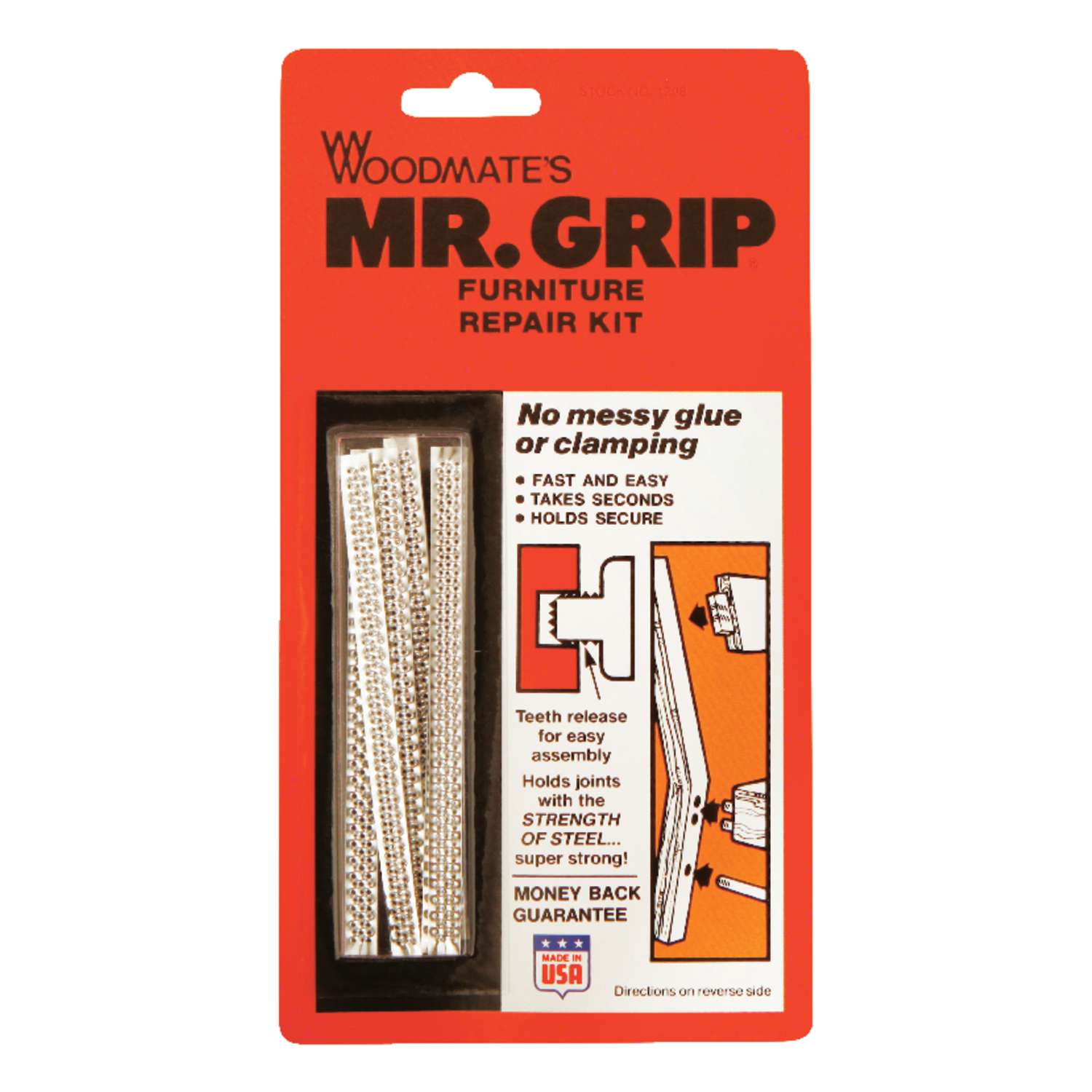

My 1st coach taped a row of thumb tacks sticking out where my finger tips tended to push on the side of the stock. That' cured me fairly quickly, but I left them on for quite a while.
I was kinder to my daughter. She was pushing with her thumb, and I put a piece of this stuff on her grip:
Problem solved...
