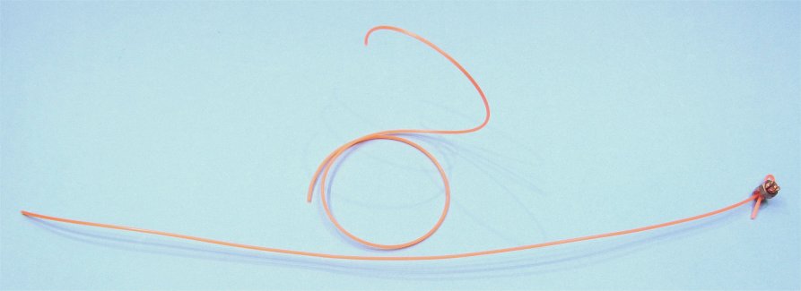

Here is a picture of the line before & after cooking:
The pieces I'm making now are actually considerably straighter. The weights I used are clamp on electrical connectors.

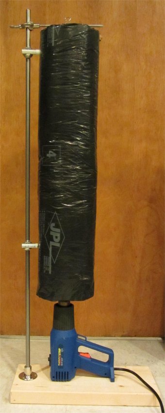

Here's a picture of the oven:
Inside the insulation jacket, there is a 24" piece of 4" stove pipe, with a 4" to 3" reducing section at the bottom. The pipe is attached to two horizontal rods through a pair of teflon insulating spacers to cut down on heat loss. The support rod & clamps are chemistry ring stand hardware. The heat gun is variable, and I've been running it at the 950F setting. Due to room air sucked in around the bottom, it's nowhere near that hot inside. I have a thermocouple temperature sensor that I use to measure the internal temperature.

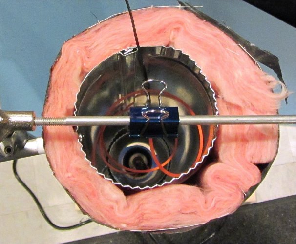

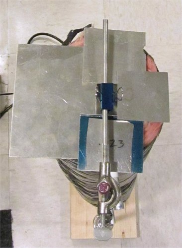

Here's a photo of a line loaded in the oven, and one of the "baffles" I have to put on the top to get the temperature up to about 400F. The black wire near the top of the 1st photo is the thermocouple cable.
It takes just a minute to cut a piece of line & load it into the oven. Cooked for about 15 minutes, they come out nice & straight, with no discoloration or bubbles from overheating. The longest time is waiting until the oven cools off enough to handle the baffles & remove the line.
The next step is to come up with a better clamping arrangement & baffles so I can try to do a couple lines at once. It would also be nice to come up with a system so I can safely swap lines in & out while the oven & hardware are hot.
