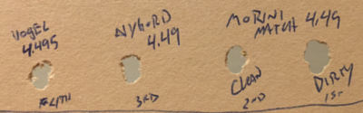

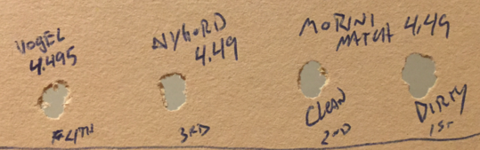

I tested this on my LP10 many years back.
The group on the far right is from a dirty barrel that had not been cleaned in years. Then I shot the groups from right to left with different pellets. Cleaning does improve the group size but for most people it may not be something to be concerned about.

Chris wrote:I tested this on my LP10 many years back.
You had corroded lead in your bore. Removing that will increase accuracy, but you need a few fouling shots to lead the barrel with clean material.

Andre,
In this case it did not appear like any fouling shots were necessary.

Chris wrote:Andre,
You have one group with a dirty barrel, then three groups with all different pellets. You can't test to see if your groups are getting better with fouling shots if your not using the same pellet. Not a fair comparison.

Post by Chris »
I do agree with you that a fouling shot or two may be necessary. My second group performed about normal for that pellet.
In my experience with my .22 prone gun is it only takes one fouling shot to get it to shoot the same group.
