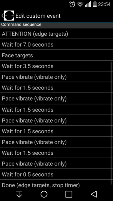

Can you add a "bip" option to the command sequence of the custom event?
It would be great to get the timing right when dry firing the 20 and 10 seconds for example.
One could create the event, then add the bips at the time he/she would like the shots to go off.
Best regards and thanks again for a great app!
ToTheZeroth
Posts: 14
Joined: Thu May 21, 2015 4:14 pm
Re: 25m Pistol Timer (new Android app with shot detection)
Post by ToTheZeroth »
rmca wrote:ToTheZeroth
Added to version 1.11. You now have "Pace beep" and "Pace vibrate" as options in the command sequence list. They simply beep or vibrate without resetting the timer or doing anything else. You'll have to keep track of the time totalling up to 20 or 10 seconds. It could look like this:
