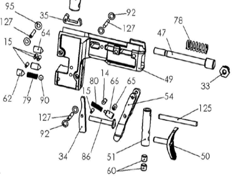

The cocking process on the AP20's gets tight towards the end, so it's a little difficult to feel the stop, but it's there. The pistols are acting as if the sear isn't quite engaging. There is no diagram of how the mechanism works, and the exploded diagram is a bit too "exploded" to see how the parts interact.
The manual talks about adjusting the "pawl", which I'm guessing is the sear. It may be that the sear engagement is too light, or that whatever stops the cocking lever isn't allowing enough rearward travel for the sear mechanism to "catch".

There is no sear in this trigger, but a blocking bar. The Striker (47) is held back cocked by the Block (35)
engaged in the groove in the Striker. The Catch Lever(34) holds the Block up until the trigger moves it out of engagement.

1 Back the trigger stop (overtravel) off to allow plenty of clearance.(screw F) [unmarked screw above pawl spring 79]
2 Put a couple of turns on pawl spring to ensure engagement (G) [second stage weight].
3 Cock the pistol (unloaded), slowly turn the Pawl engage screw (E) in until the pistol fires.
