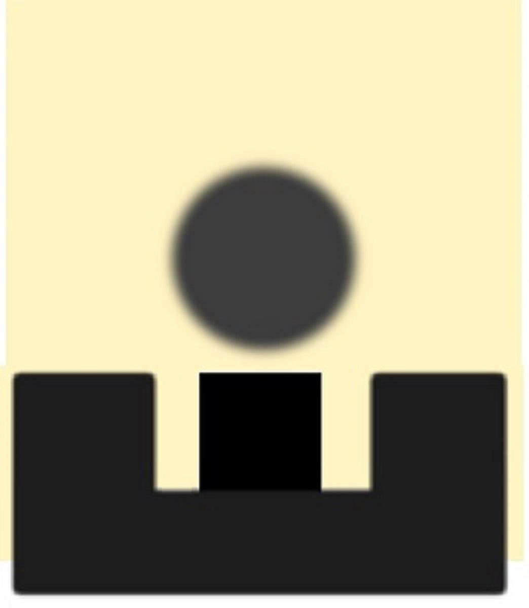

The Foresight is 70-100% of the apparent width of the target black. (above Foresight is 70% of black width)
For Precision shooting a 2:1 Rear sight (as above, 1:2:1)
The Rear sight notch is twice the apparent width of the Foresight.
Note the sight depth makes a square image of the foresight. (easy for the eye to pick).
For Rapidfire increase the ratio to 3:1, (1:1:1)
helps to acquire the sight quickly and the precision is not needed for the bigger target 10 ring.
To open up a rear sight, very careful handwork and a good eye with a new/sharp square needle file is required.
Grind the teeth off one face of the needle file to make a smooth safe edge to help keep the corners square.
Re-blue the sight when finished.

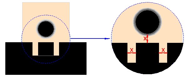

I use the "symmetry" approach recommended by the Olympic Training Center coach at a clinic several years ago. The idea is to maximize the symmetry of the image and train your brain to think of it as one image you try to maintain, and not three moving parts. The more symmetrical the image, the easier it is to train your brain to use your muscles to maintain it.
You want the perceived width of the front sight to be close to that of the width of the black. The gaps on either side of the front sight should match the gap between the black and the top of the front sight:
Sub-Six Hold.jpg (18.06 KiB) Viewed 5166 times
The size of the gaps depends on your hold & personal preference. You never want the front sight to wander off so far that it touches the inside of the rear notch. I've also heard a wider notch width recommended for older eyes. Of course, the wider the rear notch, the lower you will need to hold, but this is usually pretty minor.
I also wouldn't get too obsessed about it. Far more points are lost due to poor trigger control than a slightly "imperfect" sight picture. Lots of people have been shooting very good scores for decades with whatever the manufacturer throws on the pistol. Use the time you would spend with a file on dry firing, and the money for fancy sights on training ammo...

Very interesting concept regarding symmetry. I like it very much. In fact at my skill level I have to work on enough as it is so I really don't put much thought in to the space above my sight set and beneath the bull and it seems as if my brain wants to put about the same amount of space here as is on either side of the blade - exactly what you are saying.
