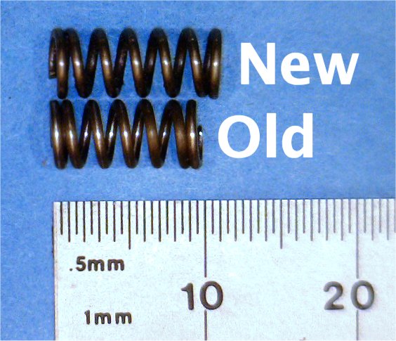

I just measured several:
Length: 11.5 mm (0.453")
Outside Diameter: 4.70 mm (0.185")
Wire Diameter: 0.72 mm (0.0284")
Turns: ~ 5.5
There are 5 full turns, plus a little extra. The ends have the last turn closed up against the previous one & then ground flat. If the action is cocked when the pistol is stored, the spring can take a "set" over time, and compress:
GKU
Posts: 26
Joined: Sun Apr 05, 2015 1:11 am
Re: IZH 46M malfunction
Post by GKU »
Thanks Gwhite !
I removed and looked at my valve spring and it was very close to its factory spec.
I remove part #12 slide latch spring and cut off a couple of coils.
Bent coil closed up against the previous one and ground flat.
It's new OAL is now 24mm off it's original OAL of 34mm.
Breech Flopping Closed When Cooking use to occured about 50% of the times, now not even once yet.
I bought an extra slide latch spring just in case.
~ GKU
Posts: 3573
Thanks! That's good to know. I suspect a lot of the problems stem from a combination of marginal heat treating of the springs, and storing the pistols cocked and/or with the breech wide open.
