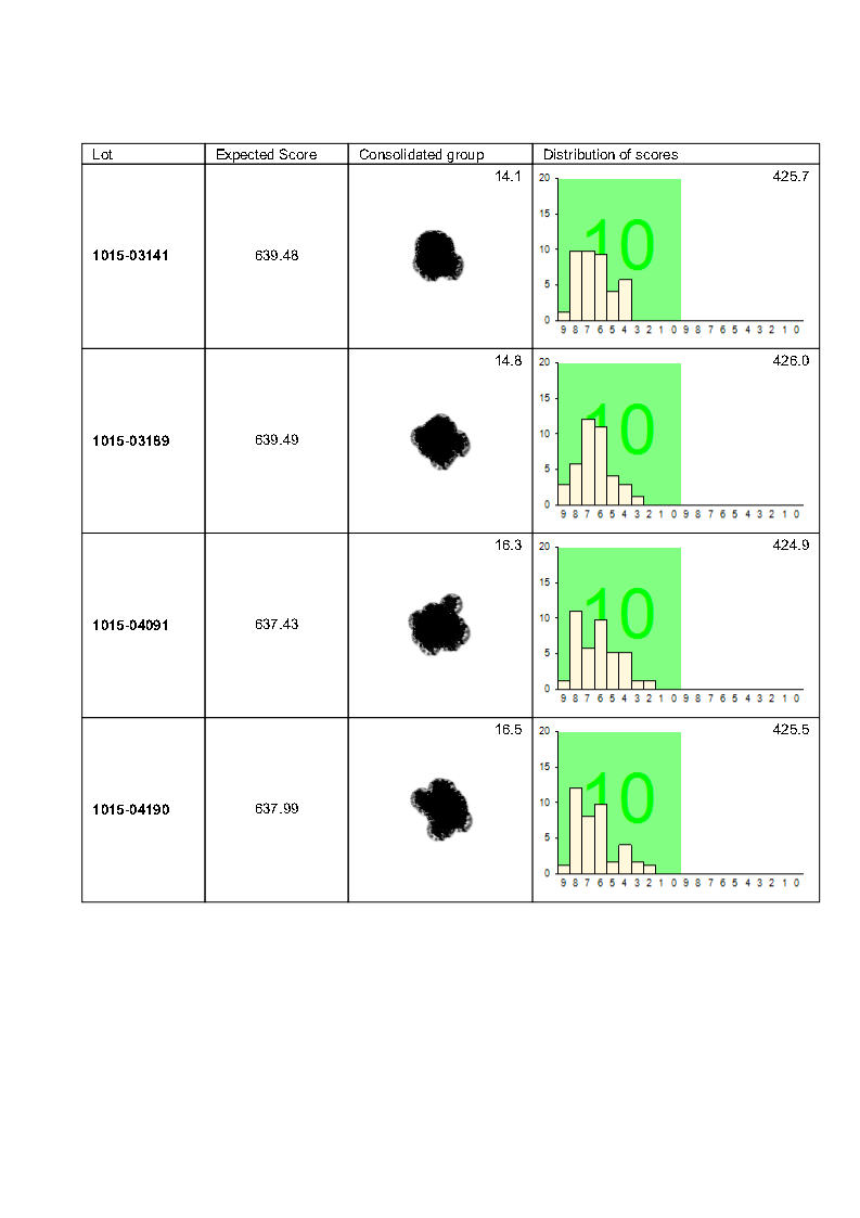

A test took place at Eley, UK recently which shows some interesting results.
Unusually, the complete stocked rifle which comprises a Bleiker Challenger, Lilja stainless barrel and a GE600 Evolution stock was tested in a recoil rest.
The first major production run should mean that GE600 stocks will be available by the end of the year. Dan Killough at Killough Shooting Sports has them on order.
For more info on this case study, please visit http://www.GE600.co.uk
PRIMU
Posts: 5
Joined: Wed Jul 01, 2015 2:11 am
Re: GE600 Evolution Stocked Rifle Testing
Post by PRIMU »
Just in case anyone was wondering, the consolidated score and group size shown in the target data is based on x 40 shots (which is the Eley protocol). The predicted score shown on the LHSof the data table represents what the likely total would be over x 60 shots. So, 639.48 effectively means an average shot of 10.65.

I don't see where they listed the test distance. 10 meters? :-) Must be hard to remove the burn marks on the target from the muzzle blast.

Eley test at 50m, what's interesting is that it's from a recoiling rig. Normally it's barrelled action clamped in a vice.
