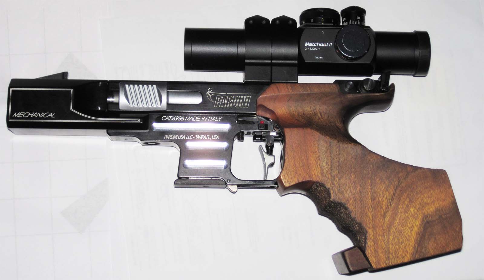

Ultradot Match 30mm Red Dot Sight
I've been shooting this red dot sight both days now that I had this gun for two weeks. I have found that the image of the dot in the sight is flawed, unclear and there are reflections and imperfections in the dot.
I have been using this dot at the lowest setting of 1 on the rheostat turret at the smallest dot size.
Dot Problems
The dot in the sight is not perfectly round since it has lines of aberration directly below the dot and also to the right side of it. The lines make it difficult to determine the center of the dot when focusing away at distance. Sometimes the dot splits in half on some shots creating a half-moon and I have even noticed that it split three-ways every so often. Very rarely is the dot a perfect circle.
Brightness Problems
The brightness of the dot at the lowest setting of 1 on the rheostat is also a problem because the dot is so bright that it blocks out the image of the target behind it and the strength of the dot creates a little star-burst effect blocking and warping the image of the target around the dot itself.
In the other red dot sights that I have, like the Millett 4 MOA dot and others that I have seen, the rheostat functions correctly and at the lowest setting the dot is only barely visible allowing you to see the image of the target behind the weak dot. The other scopes allow you to change the brightness to a setting of 3-5 to give you a nice dot indoors without any aberrations or star-burst effects. This sight is just too bright at the lowest setting not allowing you to go any lower.
Smallest Dot Size Is Not 2 MOA
The smallest dot size on this sight that is listed as 2 MOA is not actually that size. My Millet 4 MOA sight is the exact same dot size as the 2 MOA dot on this sight. Additionally my friend's Aimpoint CompC3 2 MOA sight that is listed as 2 MOA is half the size of the smallest dot on this sight. It appears to me that the 2 MOA size is only a marketing embellishment to make this sight "Match" name worthy.
The design of this Ultradot Match sight is almost identical to the Millett Multidot that it is likely that both were made by the same OEM in the same factory and just branded differently when being resold in the states. Even the little ornamental wing around the rheostat knob is the same. The Millett Multidot was listed with 3 MOA smallest dot and the Ultradot with 2 MOA dot.
The main and only reason why I decided to buy these Ultradot Match sights is because I wanted the smaller 2 MOA dot. I am unsatisfied with my current Millett 4 MOA dot size because it is too big and was covering too much of the center of the bullseye making me guestimate the center of the dot to align with the center of the bullseye.
So the main reason for me to get this sight turns out to be not true.

I seem to have the same issue with my MatchDot scope.
The dot is teardrop shape with the tail at about 4pm..
My instructor tells me that it is due to me having astigmatism ....though I am convinced it has only changed in the past moth.
Will keep an eye on it....
Any thoughts would be welcome though
Guest
Post by Guest »
If it is astigmatism the orientation of the "tail" will not change as the sight is rotated. Easy to try.
Guest
Post by Guest »
Pure genius.....rotated the scope and the teardrop stayed in place.
Removed glasses...dot is round.
Made sure I am looking through the top of my graduated bifocals....dot is nearly round.
Why has this suddenly happened.
